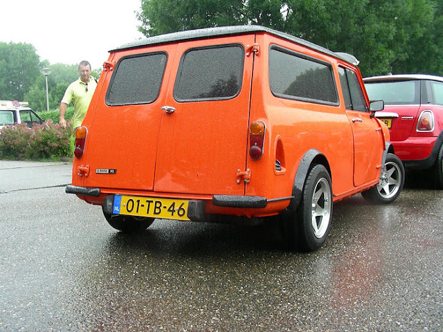

'81 Mini Van (Mini 95) in N-Brabant!
RE: '81 Mini Van (Mini 95) in N-Brabant!
Tja zoiets dus!
